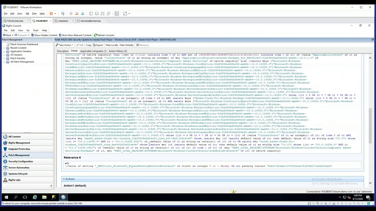

Running Actions to remote endpoints
With the above BigFix architecture in place, the administrator can deploy a patch to a remote endpoint and see its progress in real-time. This short video provides an overview of Windows patching using BigFix.
