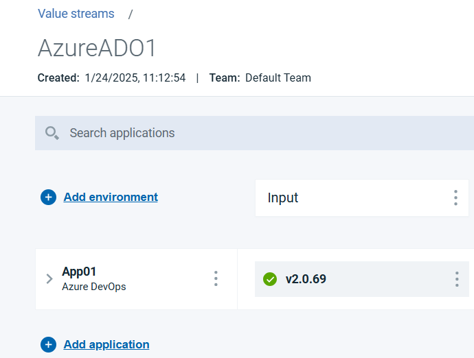

The Azure DevOps plug-in syncs the repositories, builds, pipelines, releases definitions, environments, pipeline runs, and release executions for every five minutes with to HCL DevOps Velocity. An application is created in HCL DevOps Velocity pipeline. A pipeline application is created in HCL DevOps Velocity and map the application in HCL DevOps Velocity. The build that is created after mapping the application appears as version in the Input column of the HCL DevOps Velocity pipeline.
In the following graphic,
  • App1 is the application created in HCL DevOps Velocity.
  • DevShopSphere is release created for the Azure Project.
  • Order Service is the primary artifact in the releases in Azure project.
  • V2.0.69 is the latest build number of the primary artifact created in Azure DevOps.

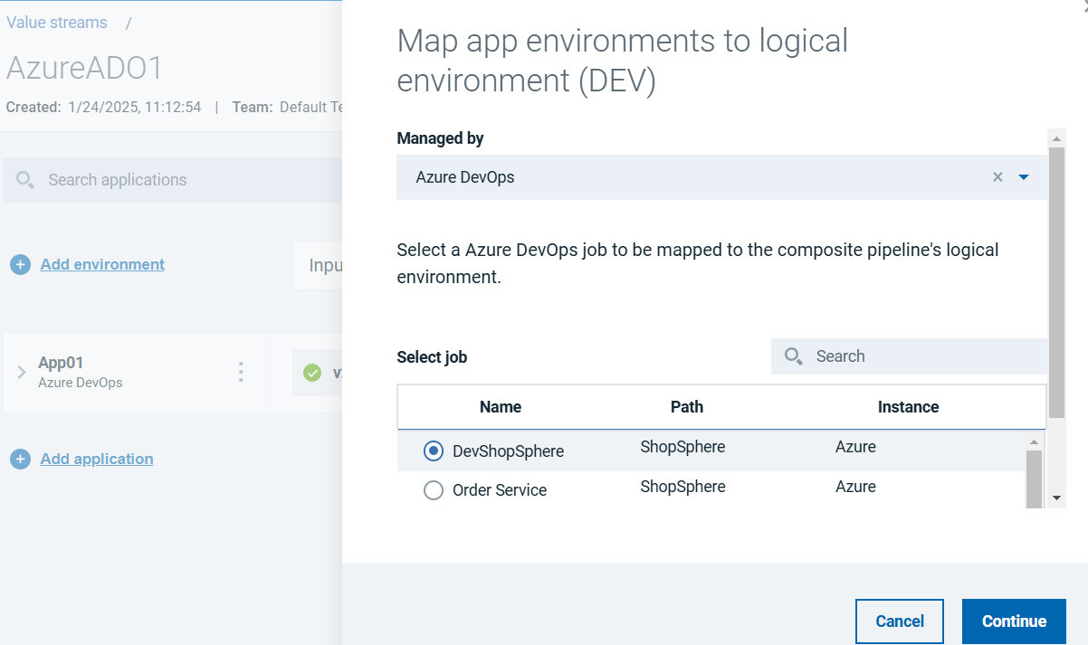

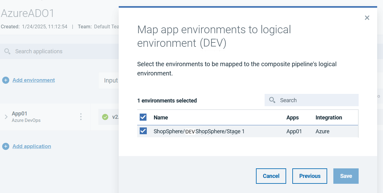

The application environment can be added in the HCL DevOps Velocity pipeline. For example, DevShopSphere is the application environment added to DEV environment for the release as shown in the following graphic.
Stage 1 is the release environment in Azure DevOps for the above release definition. The following graphic shows the mapping the Azure DevOps environment in the HCL DevOps Velocity pipeline.

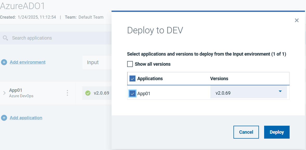

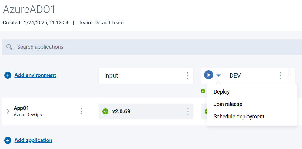

To orchestrate the deployment from HCL DevOps Velocity, select the version using the deploy option as show in the below picture.

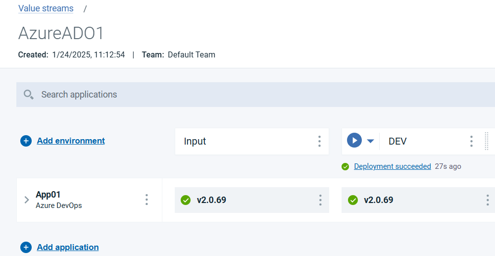

A new release is created in Azure DevOps. The deployed version is synced with HCL DevOps Velocity within 5 minutes of deployment as show in the below picture.
