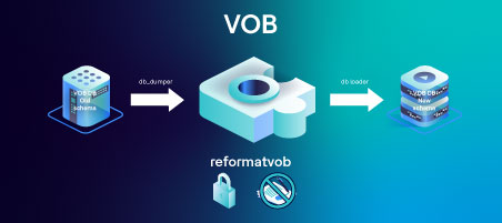

HOW STANDARD REFORMATVOB WORKS
Before getting into how the SLRV works, let’s take a quick look at how standard reformatvob works and what some of its key pain points are.
The following diagram represents a typical standard reformatvob operation being performed on a VOB.
  1. The db_dumper reads from the current schema and outputs data into a few text files.
  2. The db_loader reads those text files and writes data into the new schema.
  3. At the end of that process, directories are switched around and the new database with a new schema is available for use.
  4. The reformatvob process takes a considerable amount of time for large databases.
  5. Throughout this process, the VOB is locked and is therefore is not usable.
  6. In the UCM environments, if even a single component VOB is unavailable then all UCM operations are unavailable on that UCM project.

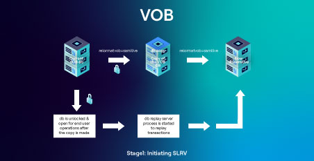

Stage 1: Initiating the semi-live reformatVOB process
In this first stage, the SLRV is started for a given VOB by issuing the command:
cleartool reformatvob -semilive <vob_stg_path>
The diagram below represents the tasks performed in this stage:
  1. The reformatvob -semilive operation silently upgrades that database to schema level 55 (if the original db is schema 54) or schema level 81 (if the original db is schema 80).
  2. The VOB is then locked.
  3. The existing database (just the VOB db directory) is copied to db.copy.
  4. The VOB is then unlocked.
  5. The copied database is dumped and loaded to db.semilive.
  6. The db_replay_server process is started to replay transactions from the current VOB db into the db.semilive copy of the database.
  7. End users can continue to work on the VOB, since the current VOB db is unlocked once the copy has been made (point 4). There is consequently no impact on end user operations.
  8. The db_replay_server process will keep replaying the new changes made in the VOB db to the new db.semilive in the background.

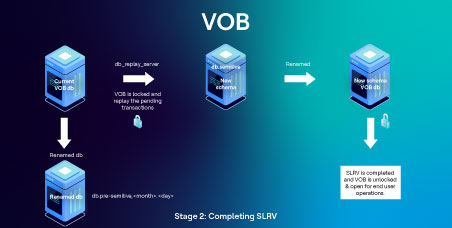

Stage 2: Completing the semi-live reformatVOB process
To complete the SLRV that is underway on the VOB, the admin runs the following SLRV complete command:
cleartool reformatvob -semilive -complete <vob_stg_path>
The diagram below represents the tasks performed in this stage after the SLRV complete command is issued:
  1. Once the “complete” command is issued, the VOB is once again locked to prevent any further changes by end users.
  2. A “complete” message is sent to the db_replay_server.
  3. The db_replay_server replays all outstanding transactions from the current VOB db to the “db.semilive” db copy and then exits.
  4. The current VOB db directory is renamed to “db.pre-semilive..” for future backup and reference purposes.
  5. The db.semilive with a schema 81 database is renamed to “db” and will act as the new upgraded db for the VOB.
  6. The VOB is unlocked and ready for use by end users, thus completing the SLRV operation.
    The VOB has now been upgraded to the new schema.
